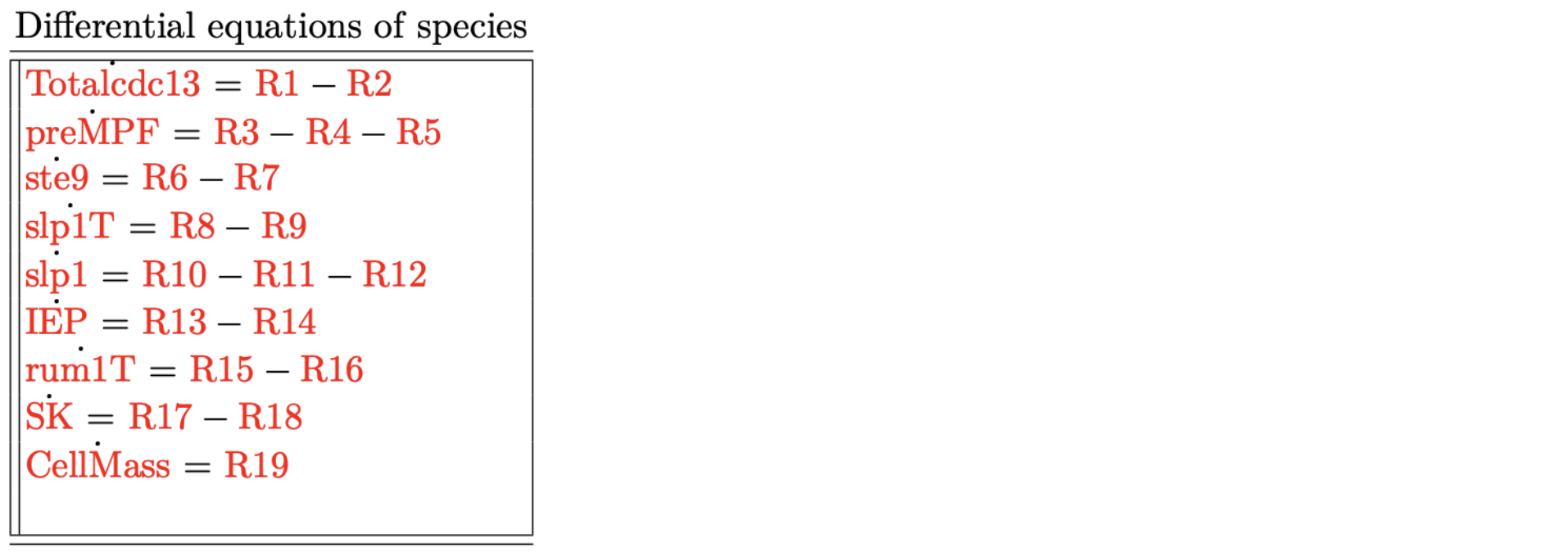

Each Core SBML network defines a system of algebraic differential equations with delays. So there are not only ordinary differential equations (ODEs), but also algebraic equations, and delay differential equations. The equations use four kinds of variables:
The XML Schema of Core SBML consists of a DTD and a Schematron. The comments of the DTD contain constraints that are formalized by the Schematron. An online documentation of the current version of the DTD csmbl-1.21.dtd is available. It is generated from the same sources than the DTD itself: csbml-1.21.dtd . A validator and the sources for the DTD and the Schematron can be downloaded with the package of the compilers. It runs on MacOS and Linux (and developers should be able to make it run under Windows).
<network id="Novak2001_FissionYeast_CellCycle" name="Novak2001_FissionYeast_CellCycle" biomodels="B111" csbml-version="1.12" ><!--

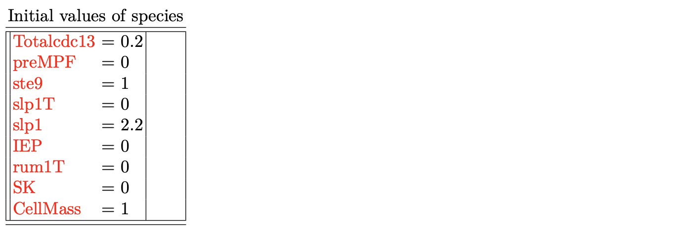

+++ start species +++++
--><!-- species without initial assignment -->
<variable type="species" id="cdc13T" latex-look="Total cdc13" initial="0.2" concentration="conc_cdc13T" compartment="cell" />

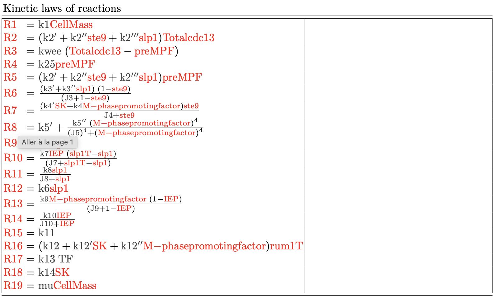

<!-- +++ start reactions +++++-->
<reaction id="R1" >
<kinetic-expression>
<times>
<expr id="k1" />
<var type="species" id="M" />
</times>
</kinetic-expression>
